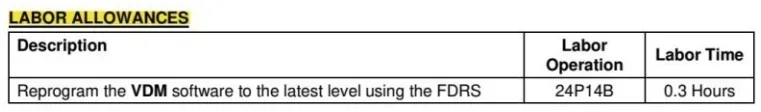

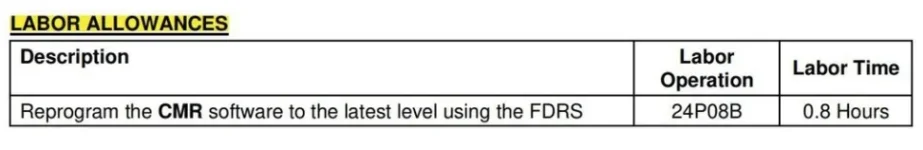

Here are the nominal durations for the two battery drain items that recently came up.
Driver Status Monitor Camera Module
Vehicle Dynamics Module (VDM), the one that can keep the CANBUS alive
