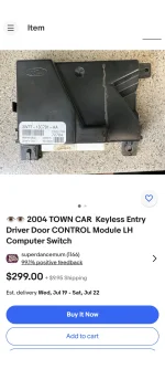

Here is the part and what it is called. This listing is current on ebay
Agreed... the listings on EBay reference it as a Keyless Entry Module. They can call it whatever they want.
On the label it says "DDM" (Driver Door Module) and it is referenced in all Ford documentation as a Driver Door Module.
Guess we'll just have to deal with different names for the same part.

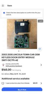

Here is another one

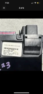

So I noticed on these parts the starting number is different mines starts with 4WIT and eBay one is 3WIT anyone know if that matters?
