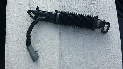

There are several on eBay. This is just one.
