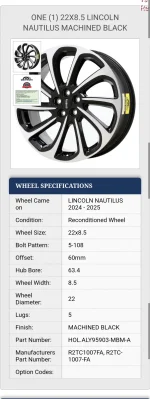

There is 4 rim sizes that are offered on the Nautilus. 19-22 inch rims. I have checked and all have the same overall diameter due to the different aspect ratio's.The speedo will not be affected as long as you are using factory size spec tires to go along with the corresponding rims. You can look at Ford.com under build and price to see the wheel tire sizes per trim.
There is talk about going to 18 inch rims you will need 255 65 18 inch tires to match all other specs.
Here is the issue trying to find an 18 rim with the correct specs for the vehicle. I reaserch for a long time and could find none.
One more item if going with 18 inch rims there could be clearance issues for the stick on wheel weights inside the rim. Spare tire are not balanced.
Saw this a few times last winter with one vehicle and during turns the deflection of the wheel bearings caused contact of the weight to the brake caliper. Had to re balance with only edge weights to clear.
