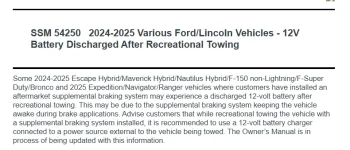

Not a surprise.....
I think many of us, maybe all of us, who tow behind a motorhome have installed some type of external power source or charging system. Great that Lincoln sent this advice and thanks for posting it. I had the Nautilis in for service and they complained about the extra wires. Now I can point them to an official reason.
