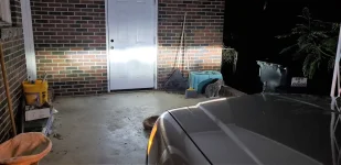

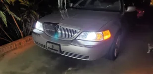

Go to PantherLights.com . The guy that runs it owns his own business of retro-fitting headlights. Basically he can customize your headlights with projectors, halos and other stuff. He also sells high-quality LED headlights that are direct plug-and-play and are made for use in regular halogen assemblies. Here's mine I got from him, I also have LED high-beams, but no pics of them
20190829_230314 (Medium).jpg20190829_230334 (Medium).jpg20190828_204458 (Medium).jpg
