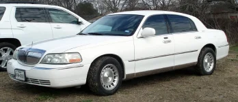

Here's a car that did it. I saw this one parked and took a pic. Not mine and don't know what kind of issues it might have had, but looks decent.
Maybe this car is 98-02 model with front end swap it's possible since swapping front end is easy if you get one from junk yard
in my opinion fitting 98-02 wheels on 03+ easer than doing the opposite

I think those wheels look really good on a newer TC. Not sure what the diameter is, 16", but these look better than a lot of Mustang wheels I've seen...IMO. Plus, part of what I was trying to gain by going to Mustang wheels was a little more offset.
