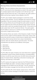

In my case, my Navigator has, from time to time, had the seat belt chime and any other subsequent warming sounds, inexplicably, come through only one speaker behind the steering wheel. This will last through an entire ignition cycle. Lincoln can't figure it out, or just doesn't care.

The dealer replied to me tha the change in chimes is normal in certain situations. I told them it changes the mode like people we know. 😬
