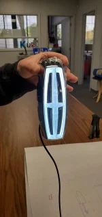

I had mine installed today at my local Ford Dealer for $130. My only complaint is that it stays lit for 10 minutes after I turn the car off.

Here’s what my Service Advisor told me when I asked him about the LED staying on after I turn the car off, “Good morning Aaron, the emblem will stay lit for about 5-10 minutes before it "times out" and turns it self off. It draws a tiny amount of voltage, it will not drain your battery. It stays energized until the power in the "resistor goes to sleep" and shuts down as it's designed to.”

Hi Aaron. The Lincoln emblem is turning off after 10 minutes because it is wired into a circuit which is monitored by the Battery Saver feature of the vehicle.
The Battery Saver feature turns off switched circuits 10 minutes after the engine/ignition is turned off. So items like the headlights, interior lights etc. will be turned off by the Battery Saver feature after 10 minutes. Also the Audio system, although opening a front door before the 10 minute period will also turn it off.
However, the "...resistor goes to sleep" and shuts down as it's designed to.” explanation by the Service Advisor was a colorful explanation. 🙃:ROFLMAO:
It looks good though! Good luck! 🍻

Any recommendations on a better way to wire it? I watched a YouTube video where the guy put used an “add a fuse” and plugged it into spot 34.

Hi AaronZ. I was not implying the way the Dealer wired it up was wrong (if an owner does not mind them staying on for 10 minutes after they leave their vehicle), only that the explanation the Service Advisor gave as to why they were staying on for 10 minutes was "creative". 🙃
If I were to install a modification like this (although it is nice, I probably wouldn't), I would wire it to a switched circuit which turns off when the vehicle was turned off, or at least one that turned off when the driver/front passenger door was opened, as the audio system/power windows etc. do.
If I understand the YouTube video correctly, you would need to be running a new wire from the illuminated Lincoln badge through the engine compartment, then through the firewall to the fuse box to "slot 34". I don't have the 2020 Continental fuse box diagram handy, and don't want to be the one to tell you to wire things differently (possibly jeopardizing any Dealer warranty), so I will leave that to someone else more comfortable telling others how to modify their vehicle electrical systems. 🤔
If you are not comfortable having them stay on 10 minutes as they are now, I would ask the Dealership to rewire it to a switched circuit which shuts off when the ignition is turned off, as mentioned above, instead of counting on the Battery Saver feature to turn them off after 10 minutes. That is the advice I feel comfortable offering. Hope you understand why. 🤗
Keep us updated and good luck. 🍻
