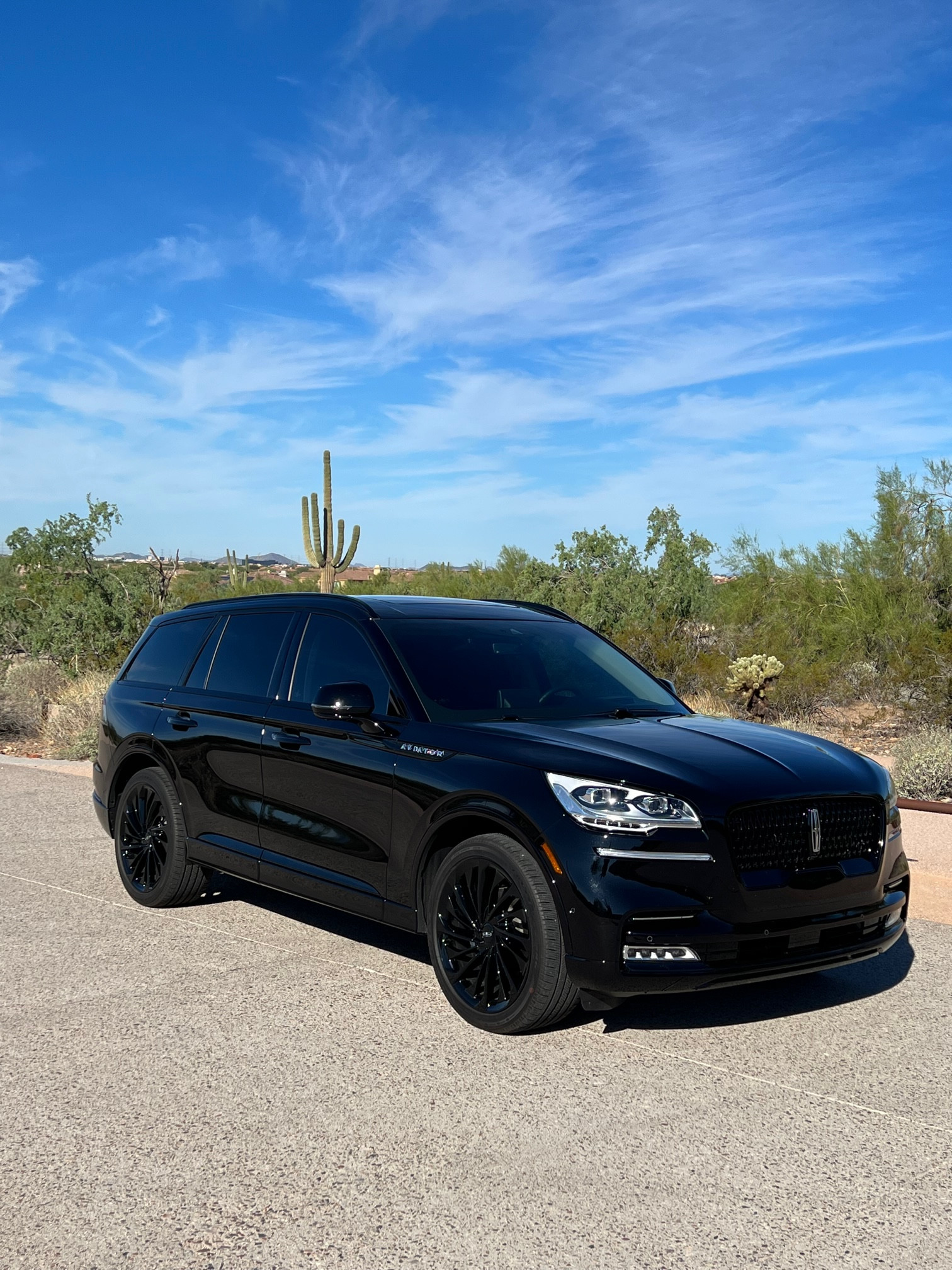

Pic below is of my recent rented one, was the perfect spec !!
