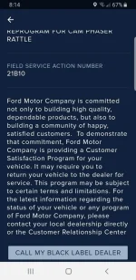

Update: see there is a Field Service Action 21B10 issued to reprogram powertrain module for cam phaser rattle. My 18 NavL Reserve due oil change so I asked Service Agent about this FSA, especially since I had done phaser replacement in 19.
He responded Ford has put a hold on this FSA because reprogram is creating transmission shifting problems.

I just received this notification on my 2018 navigator on the Lincoln app.
